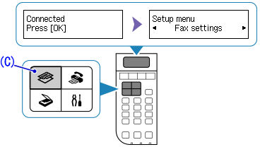

8. When the left screen appears, press the [ OK ] button.
Press the [ COPY ] button (C).
REFERENCE
If a different screen appears, see "If an Error Screen Appears" below in this page and follow the instructions there.
The wireless LAN setup using WPS is completed.
