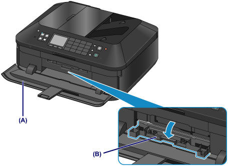

  1. If necessary, detach the disc tray from the upper cassette.
  2. Hold the sides of the paper output tray (A), and gently open it.
  3. When the message asks you to load the printable disc, open the inner cover (B) and push it down all the way to the bottom.
    Caution Don't insert the disc tray until you see a message that asks you to load the printable disc. Doing so can damage the machine.

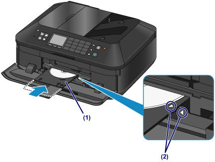

  4. Gently press the CD in place with the printable side facing up.
    Caution Make sure there isn't any dirt on the disc tray.
    Caution Be careful not to touch the printable surface of the CD or the reflectors (C) on the tray.
    placing a disc into the tray - shown without touching disc surface or reflectors.
  5. Insert the disc tray straight until the arrow left arrow on the inner cover is almost aligned with the arrow  right arrow on the disc tray.
    Caution Be careful not to insert the disc tray beyond the arrow  left arrow on the inner cover.
    disc tray being inserted into the upper cassette slot
    Note The disc tray may eject after a period of time. In this case, follow the on-screen instructions to attach the disc tray.
