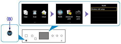

1. Press the HOME button (A) on the printer.

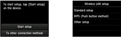

 2. Flick the screen left or right, then tap the [ WLAN ]. Tap [ Wireless LAN setup ]. The Wi-Fi lamp (B) flashes when wireless connection is enabled. 3. When the screen left above is displayed, go to the step 4. When the screen right above is displayed, go to the step 5. 4. Tap [ To other connection methods ] on the printer. 5. Tap [ Standard setup ]. 6. Tap your access point. REFERENCE If a different screen appears, see "If an Error Screen Appears" below in this page and follow the instructions there.

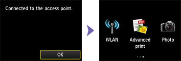

7. Either of the following screens should be displayed: If [ Connected to the access point. ] appears on the printer, the network does not require a password. REFERENCE If a different screen appears, see "If an Error Screen Appears" below in this page and follow the instructions there.

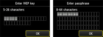

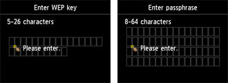

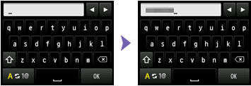

8. Tap the screen. 9. Enter the network password (WEP key or passphrase). Character entry is case-sensitive so be sure to confirm. REFERENCE - Character Entry You can enter the characters when the keyboard is displayed on the printer. Follow the procedure below. (1) You can enter the characters when the keyboard is displayed on the printer screen. Character entry is case-sensitive.
 : Tap to switch between "lower case letters" and "numbers and symbols."
 : While letters of the alphabet appear, tap to switch between upper and lower case letters. While numbers and symbols appear, tap to switch symbol types.
 : Tap to insert a space.
 : Tap to delete the character at the cursor. Use
 to move the cursor to the target character. (2) Tap the character you want to enter. (3) Repeat 1 and 2 to enter the remaining characters. - To insert characters, move the cursor to the character on the right of the target position using the
 and tap characters.
10. Tap [ OK ]. 11. Make sure that the network password is correct. Character entry is case-sensitive. 12. Tap [ OK ]. REFERENCE If a different screen appears, see "If an Error Screen Appears" below in this page and follow the instructions there.
13. When the left screen appears, tap [ OK ]. REFERENCE If a different screen appears, see "If an Error Screen Appears" below in this page and follow the instructions there.
