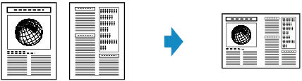

About Special copy Menu The following menus are selectable in the Special copy menu. When copying thick originals such as books, you can make a copy without black margins around the image and gutter shadows. Refer to [ Copying Thick Originals Such as Books ] within this webpage. You can copy images so that they fill the entire page without borders. Refer to [ Copying without Borders ] within this webpage. You can copy two original pages onto a single sheet of paper by reducing each image. Refer to [ Copying Two Pages to Fit onto a Single Page ] within this webpage. You can copy four original pages onto a single sheet of paper by reducing each image. Refer to [ Copying Four Pages to Fit onto a Single Page ] within this webpage. You can obtain sorted printouts when making multiple copies of a multi-paged original. Refer to [ Making Multiple Copies of an Entire Document ] within this webpage. Copying Two Pages to Fit onto a Single Page You can copy two original pages onto a single sheet of paper by reducing each image. 1. Make sure that the machine is turned on. 2. Load paper. 3. Press the COPY button. The Copy standby screen is displayed. 4. Press the Menu button. The Copy menu screen is displayed. 5. Use the
![](https://s7d1.scene7.com/is/image/canon/G0052438?scl=1) button to select Special copy, then press the OK button. 6. Use the
![](https://s7d1.scene7.com/is/image/canon/G0052438?scl=1) button to select 2-on-1 copy, then press the OK button. If a page size setting or a media type setting that cannot be used in 2-on-1 copying is selected, the LCD displays the following message. (1) Use the
![](https://s7d1.scene7.com/is/image/canon/G0052438?scl=1) button to select the page size, then press the OK button. (2) Use the
![](https://s7d1.scene7.com/is/image/canon/G0052438?scl=1) button to select the media type, then press the OK button. 7. Load the original document on the platen glass or in the ADF. 8. Use the
![](https://s7d1.scene7.com/is/image/canon/G0052437?scl=1) (-)
![](https://s7d1.scene7.com/is/image/canon/G0052438?scl=1) (+) button or the Numeric buttons to specify the ->. Change the print settings as necessary. Refer to [ Setting Items ] within this webpage. 9. Press the Color button for color copying, or the Black button for black & white copying. - When the document has been loaded on the platen glass:
When the machine finishes scanning the first document, the message below is displayed. If you have the next sheet of document to scan, load it on the platen glass and press the OK button. The machine starts copying. If you do not need more scanning, press the tone button to start copying. The machine starts copying. REFERENCE - You can add the copying job while printing.
- When the document has been loaded in the ADF:
The machine starts scanning the next sheet of document automatically after one sheet of document finishes being scanned. REFERENCE - If Memory is full appears on the LCD when scanning, set the image quality to Standard or reduce the number of sheets of documents, then try copying again. If the problem is not resolved, set the image quality to Fast and try copying again.

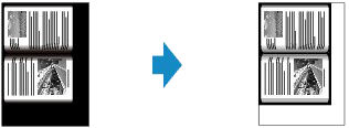

Copying Thick Originals Such as Books When copying thick originals such as books, you can make a copy without black margins around the image and gutter shadows. Using this function, you can reduce unnecessary ink consumption. 1. Make sure that the machine is turned on. 2. Load paper. 3. Press the COPY button. The Copy standby screen is displayed. 4. Press the Menu button. The Copy menu screen is displayed. 5. Use the
![](https://s7d1.scene7.com/is/image/canon/G0052438?scl=1) button to select Frame erase copy, then press the OK button. 7. Load the original on the platen glass. REFERENCE - When you use this function, load the original on the platen glass.
8. Use the
![](https://s7d1.scene7.com/is/image/canon/G0052438?scl=1) (+) button or the Numeric buttons to specify the ->. Change the print settings as necessary. Refer to [ Setting Items ] within this webpage. 9. Press the Color button for color copying, or the Black button for black & white copying. The machine starts copying. REFERENCE - Close the document cover.
- There may be a narrow black margin that appears around the image. This function removes the dark margins only. If a scanned book is too thin or when the machine is used near a window or in a bright environment, a faint black frame may remain. Also, if the color of an original is dark, the machine cannot distinguish the document color from the shadow and this may cause slight cropping or a shadow on the crease.

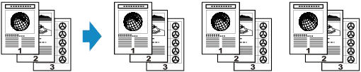

Making Multiple Copies of an Entire Document You can obtain sorted printouts when making multiple copies of a multi-paged original. - When Collated copy is selected:
- When Collated copy is not selected:
1. Make sure that the machine is turned on. 2. Load the paper. 3. Press the COPY button. The Copy standby screen is displayed. 4. Press the Menu button. The Copy menu screen is displayed. 5. Use the
![](https://s7d1.scene7.com/is/image/canon/G0052438?scl=1) button to select Collated copy, then press the OK button. 7. Load the original in the ADF. REFERENCE - When you use this function, load the original in the ADF.
8. Use the
![](https://s7d1.scene7.com/is/image/canon/G0052438?scl=1) (+) button or the Numeric buttons to specify the ->. Change the print settings as necessary. Refer to [ Setting Items ] within this webpage. 9. Press the Color button for color copying, or the Black button for black & white copying. The machine starts copying. REFERENCE - The number of pages the machine can read varies with the document. If Memory is full appears on the LCD when scanning, reduce the number of document pages to scan and try copying again.
