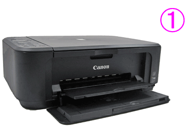

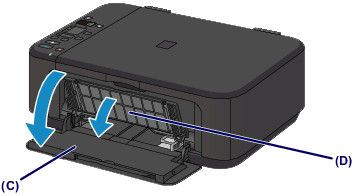

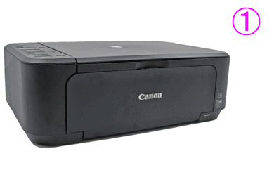

  1. Turn the printer ON, and open the front cover (C), and the paper output tray (D) (see slide images below).

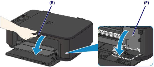

  1. Open the paper output cover (E). The ink cartridge holder moves to the replacement position, and the head cover (F) automatically opens (see slide images below).
     Don't try to stop or forcibly move the ink cartridge holder. Don't touch the metallic parts or other parts inside the machine.
     If the output cover is open for more than 10 minutes, the cartridge holder moves to the far right and the Alarm lamp lights. In this case, close, then reopen the output cover.

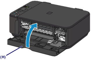

  1. Close the paper output cover (H).
