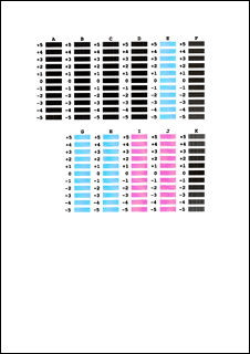

Load three sheets of A4 size or Letter size plain paper into the front tray.
Make sure that the machine is on and click Align Print Head.
Follow the instruction in the message.
Enter the numbers of the patterns with the least amount of streaks in the associated boxes, and click Send.
If it is difficult to pick the best pattern, pick the setting that produces the least noticeable vertical white streaks.
(A) Less noticeable vertical white streaks
(B) More noticeable vertical white streaks
If it is difficult to pick the best pattern, pick the setting that produces the least noticeable horizontal white streaks.
(A) Less noticeable horizontal white streaks
(B) More noticeable horizontal white streaks

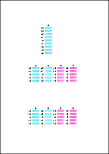

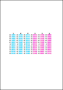

The second pattern is printed.
Do not open the document cover while printing is in progress.
Confirm the displayed message and click OK
The third pattern is printed.
Do not open the document cover while printing is in progress. -
Enter the numbers of the patterns with the least noticeable horizontal stripes in the associated boxes, and click Send.
If it is difficult to pick the best pattern, pick the setting that produces the least noticeable horizontal white stripes.
(A) Less noticeable horizontal white stripes
(B) More noticeable horizontal white stripes
