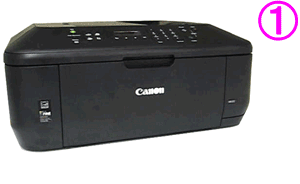

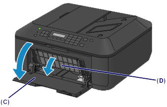

  1. Make sure that the power is turned on, open the front cover (C), then open the paper output tray (D).

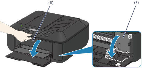

  2. Open the paper output cover (E).
    When the ink cartridge holder moves to the replacement position, the head cover (F) OPENS AUTOMATICALLY.
 Important
  • Do not hold the ink cartridge holder to stop or move it forcibly. Do not touch the ink cartridge holder until it stops completely.
  • The head cover will open automatically after you open the paper output cover.
If you have closed the head cover while replacing an ink cartridge, close the paper output cover, then open it again.
Trying to force open the head cover with your hand may cause the printer to malfunction.
  • Do not touch the metallic parts or other parts inside the printer.
  • If the paper output cover is left open for more than 10 minutes, the ink cartridge holder moves to the far right and the Alarm lamp lights. In this case, close the paper output cover, then open it again.

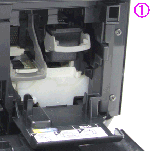

  1. Remove the empty ink cartridge.
    1. Push down the ink cartridge lock lever until it clicks.
    2. Remove the ink cartridge.
 Important
  • Handle the ink cartridge carefully to avoid staining of clothing or the surrounding area.
  • Discard the empty ink cartridge according to the local laws and regulations regarding disposal of consumables.

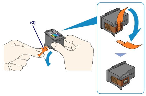

  1. Prepare a new ink cartridge.
    1. Take a new ink cartridge out of its package and remove the protective tape (G) gently.
 Important
  • If you shake an ink cartridge, ink may spill out and stain your hands and the surrounding area. Handle an ink cartridge carefully.
  • Be careful not to stain your hands and the surrounding area with ink on the removed protective tape.
  • Do not reattach the protective tape once you have removed it. Discard it according to the local laws and regulations regarding disposal of consumables.
  • Do not touch the electrical contacts or print head nozzle on an ink cartridge. The printer may not print properly if you touch them.

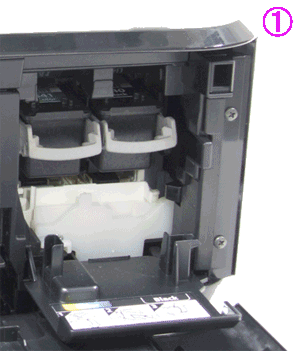

  1. Install the ink cartridge.
    1. Insert the new ink cartridge straight into the ink cartridge holder all the way until it touches the back.
      The color ink cartridge should be installed into the left slot and the black ink cartridge should be installed into the right slot.
 Insert the ink cartridge gently so that it does not hit the electrical contacts on the ink cartridge holder.
  1. Push up the ink cartridge lock lever to lock the cartridge into place.
    The cartridge is locked into place when the ink cartridge lock lever clicks.
 Important
  • Check if the ink cartridge is installed correctly.
  • The printer cannot print unless the color ink cartridge and black ink cartridge are installed. Be sure to install both cartridges.

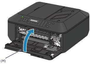

  1. Close the paper output cover (H).
 Note
  • If an error message appears after the paper output cover is closed, take appropriate action.
  • When you start printing after replacing the ink cartridge, the printer starts cleaning the print head automatically. Do not perform any other operations until the printer completes the cleaning of the print head.
  • If the print head is out of alignment, as indicated by misaligned printed ruled lines or similar symptoms, adjust the print head position.
  • The printer may make noise during operation.
