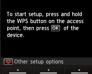

  4. The printer searches for access points (routers). If a WPS-compatible access point is detected, the following screen appears.
    LCD screen shot showing instructions to press the WPS button on the router
  5. Press and hold the WPS button on your router for 5 seconds, then press OK on the printer's operation panel.
    Note For specific details on your router's WPS button operation, refer to your router documentation.

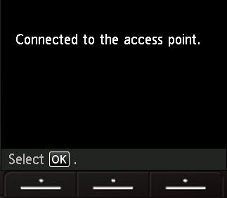

  6. Press OK when Connected to the access point appears.
    LCD screen shot showing 'Connected to the access point'
    Note If the timeout error screen appears, press OK, then start over from step 4.
  7. Your printer is now connected to your Wi-Fi network.
