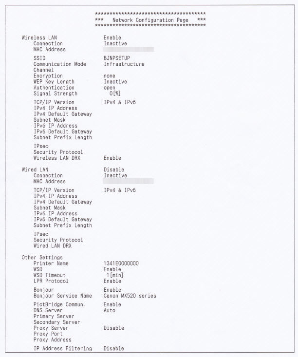

The machine starts printing the network setting information. The following is an example of a LAN details page:
