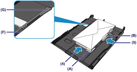

Load envelopes:
Pull out cassette 2 from the machine.
Slide the paper guide (A) in front and (B) on the right to open the guides.
Load the envelopes WITH THE PRINT SIDE FACING DOWN, and place them in the center of cassette 2.
The folded flap of the envelope will be faced up on the left side.
(C) Rear side
(D) Address side
Up to 10 envelopes can be loaded at once.
Align the envelope stack with the edge of cassette 2 as shown in the figure below. If the envelopes are in contact with the protrusion (E), the envelopes may not be fed properly.
Align the paper guide (A) in front with the envelopes.
Slide the paper guide (B) on the right to align the right and left guides with sides of the envelopes.
Do not slide the paper guides too hard against the envelopes. The envelopes may not be fed properly.
Do not load envelopes higher than the load limit mark (F).
Keep the envelope stack height below tabs (G) of the paper guides.
Push cassette 2 into the machine until it stops.

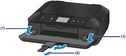

Open the paper output tray:
Holding sides of the paper output tray, gently open it.
The output tray extension opens automatically when the paper output tray is opened.
Extend the paper output support.
