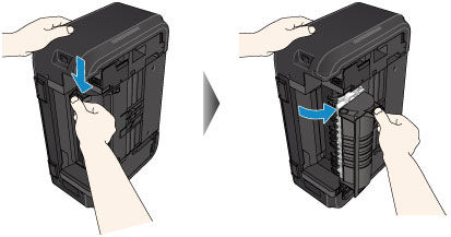

Remove jam from the back of the printer
Watch this video or follow the written instructions below.
Written instructions
  1. Turn the machine off, then unplug the power cord.
  2. Stand the machine with the right side facing down.
 When you stand the machine, confirm that the document cover is closed.
  • Stand the machine on a wide and flat surface such as a desk.
  • When you stand the machine, hold it securely and be careful not to hit it on a hard object
  • If the protective material for the transport unit remains attached (orange, plastic packaging), remove it.
  1. Push the open lever to open the transport unit, while you support the machine with your hand so it doesn't fall down.
  2. Pull the jammed paper out slowly, while you support the machine with your hand so that it doesn't fall down.
     If the paper is rolled up and it's difficult to remove, carefully pull out the edges of the paper. Then remove the jammed paper
  3. Close the transport unit and return the printer to its normal position .
  4. Plug the machine back in and turn it on.
  5. Reload the paper.
