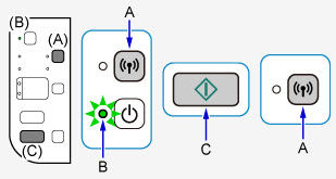

  1. Press and hold the Wi-Fi button (A) on the printer until the ON lamp (B) flashes.
  2. Press the Color button (C), then the Wi-Fi button (A).
    Figure shows Wi-Fi button (A), On lamp (B), and Color button (C)
  3. Make sure that the Wi-Fi lamp (D) flashes quickly and the ON lamp is lit.
    Wi-Fi lamp (D) flashing
  4. When the Wi-Fi lamp (D) flashes quickly, the printer is ready to receive information from the wireless network.

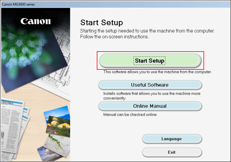

  8. Select Start Setup.
    Select Start Setup (outlined in red)

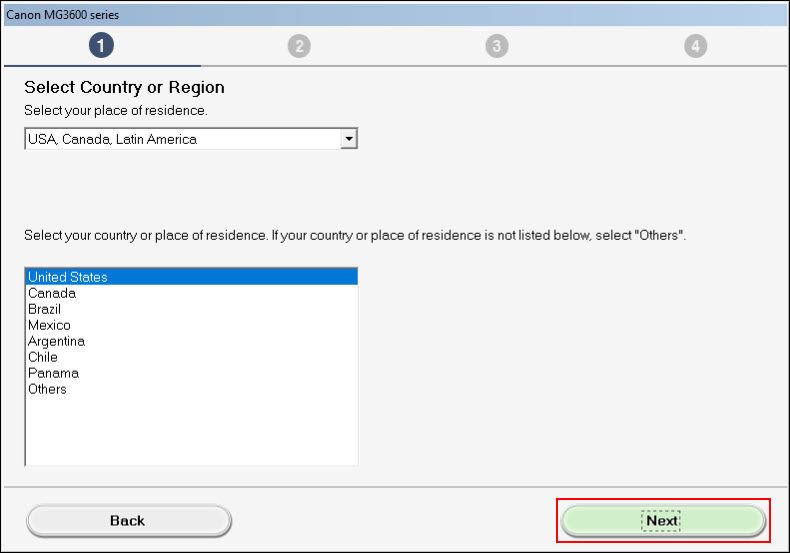

  9. When this screen appears, select your place of residence, then select Next.
    Select your place of residence, then select Next (outlined in red)

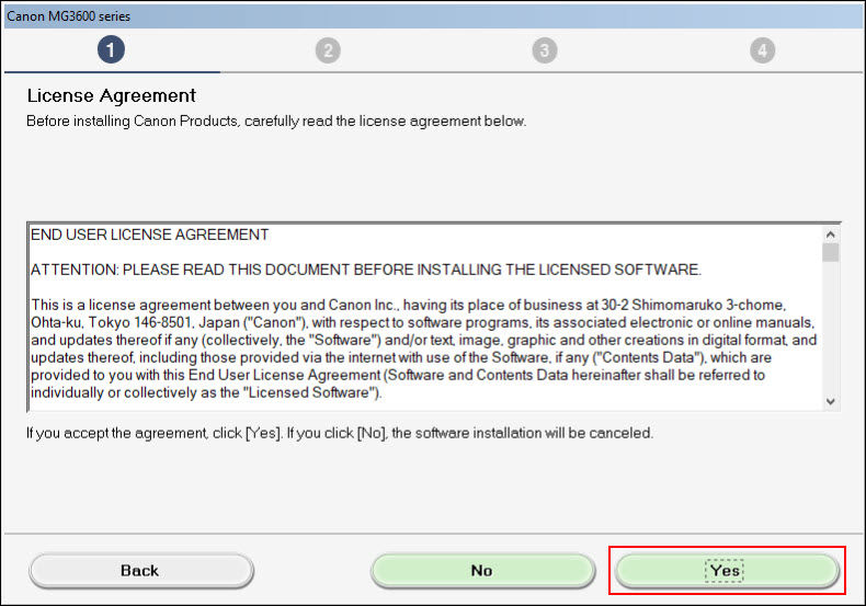

  10. Read the License Agreement, then select Yes to proceed. If you select No, the installation will not proceed.
    Select Yes to proceed (outlined in red)

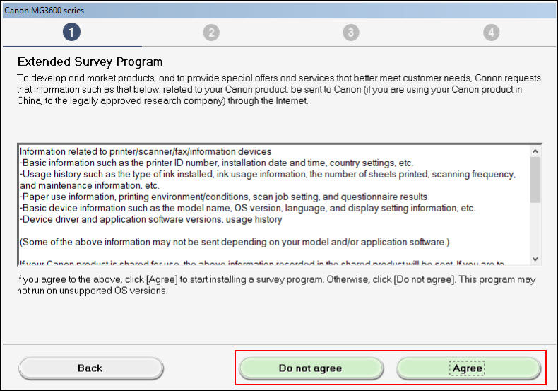

  11. Read the information regarding the Extended Survey Program. Select Agree or Do not agree to proceed.
    Select Agree or Do not agree (outlined in red)

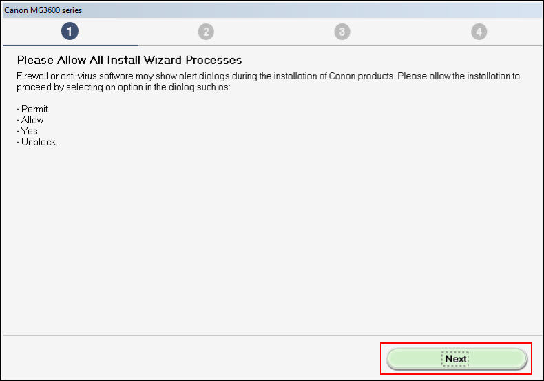

  12. Select Next when prompted to allow all Install Wizard processes.

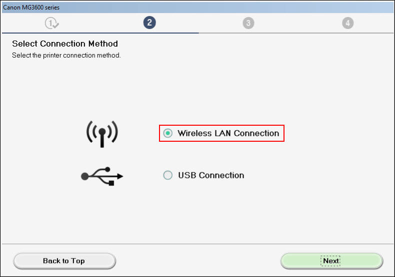

  13. Select Wireless LAN Connection, then select Next.
    Select Wireless LAN Connection (outlined in red), then select Next (outlined in red)

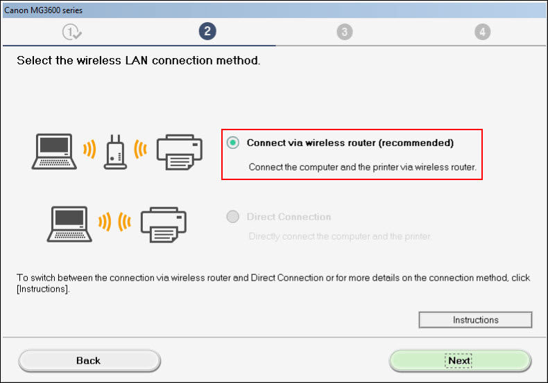

  14. Select Connect via wireless router (recommended), then select Next.
    Select Connect via wireless router (recommended) (outlined in red), then select Next (outlined in red)

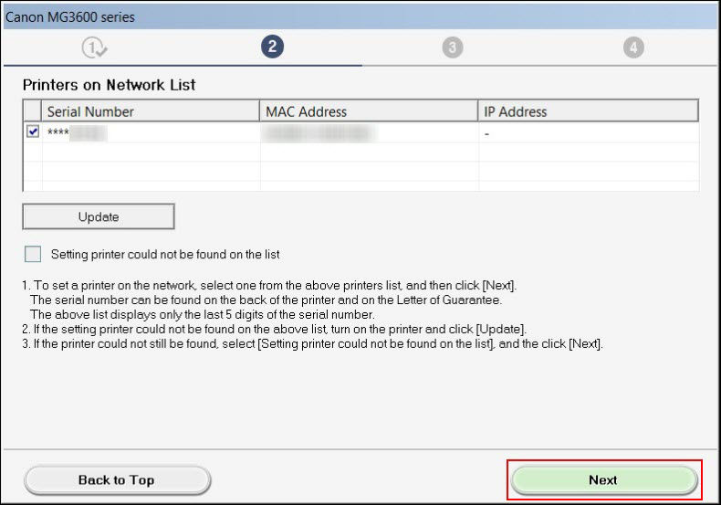

  17. When the Printers on Network List screen appears, make sure that your printer is selected (shown by a check in the box
    on the left), then select Next.
    Make sure the printer is selected, then select Next (outlined in red)

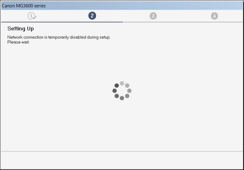

  18. Your computer will temporarily disconnect from your wireless network. It will then communicate directly with the printer,
    sending it the information it needs to connect to your wireless router.
    The network connection is temporarily disabled

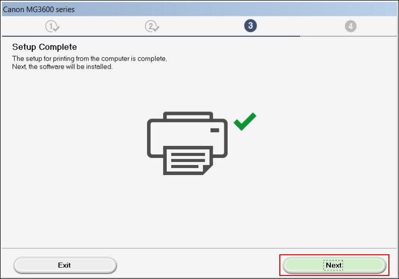

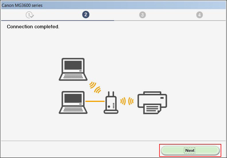

  20. The connection is completed. Select Next.
    Select Next (outlined in red)

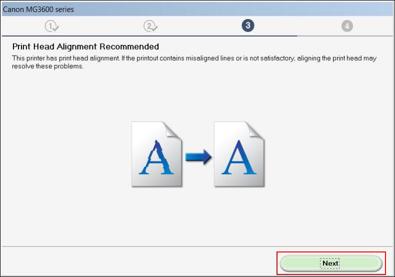

  21. After the MP Drivers for the printer have been downloaded and installed (this may take several minutes), the Print
    Head Alignment Recommended
     screen will appear. Select Next.

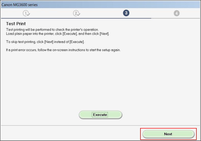

  22. Select Execute to perform a test print, if desired. To skip this, select Next.
    Select Next (outlined in red) to proceed

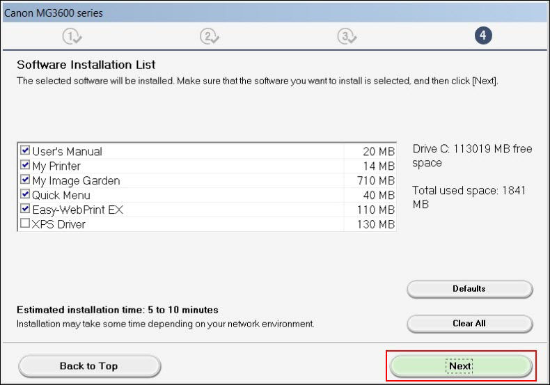

  24. Place a check in the boxes for any software you would like to install. Select Next to proceed.
    If you do not want any of the software in this list, select Clear All, then select Next.
    Select any software you wish to install, then select Next (outlined in red)

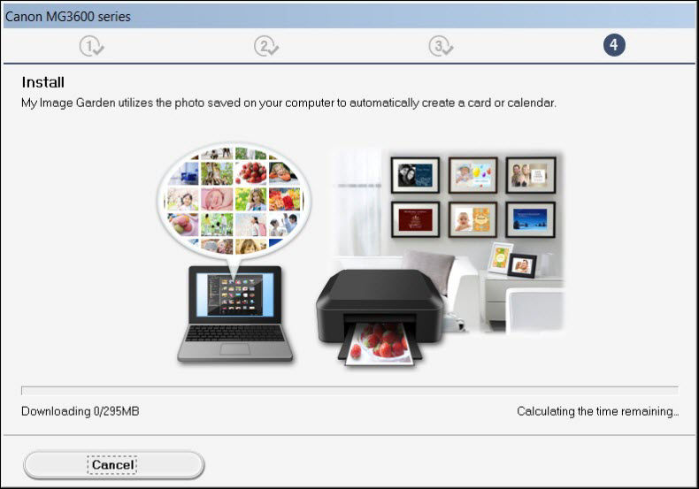

  25. If you chose any software in the list, it will be downloaded and installed. This may take several minutes.
    The software chosen will be downloaded and installed

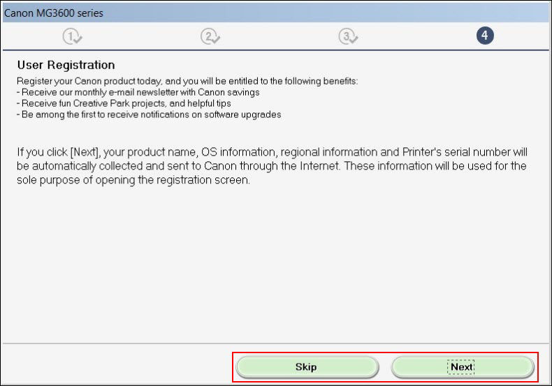

  26. If you would like to register the printer, select Next. Select Skip if you do not want to register.
    Select Skip or Next (outlined in red)

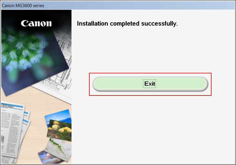

  27. Select Exit.
    Select Exit (outlined in red)
