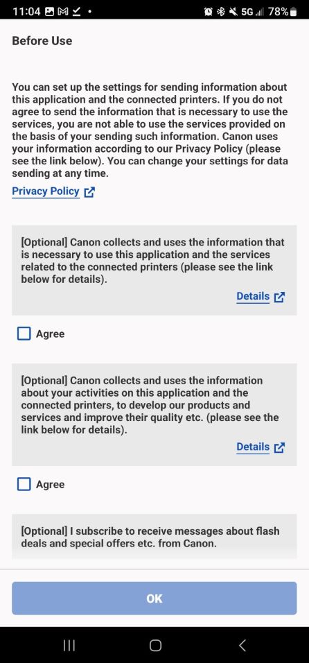

  4. The optional For using services related to Canon product screens will appear. Read this information, then tap the checkboxes to Agree if you wish to opt into these items.
