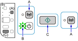

To place the printer in the cableless setup mode, follow these steps.
  1. Hold down the Wi-Fi button (A) on the printer until the ON lamp (B) flashes, then release the Wi-Fi button (A).
  2. Press the Color button (C) then the Wi-Fi button (A).
  3. Make sure that the Wi-Fi lamp (D) flashes quickly and the ON lamp is lit.
    Figure: Wi-Fi lamp flashing quickly
The printer is now in cableless setup mode. It is waiting to receive the information needed to connect to your wireless network.
