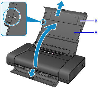

  2. Open the rear tray cover (A).
    The paper output slot cover will open automatically.
  3. Pull out the paper support (B) until the arrow ( ) mark is aligned with the arrow ( ) mark.

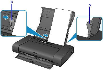

  4. Slide the paper guide (C) to the left, and load the envelopes against the far right (D) of the rear tray WITH THE PRINT SIDE FACING YOU.
    The folded flap of the envelope will be faced up on the left side.
    Up to 10 envelopes can be loaded at once.
  5. Slide the paper guide (C) to align it with the envelopes.
    Do not slide the paper guide too hard against the envelopes. The envelopes may not be fed properly.

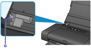

    • Keep the envelope stack height below the tab (G) of the paper guide.

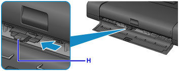

  6. Set the paper thickness lever (H) to the left.
     Note
    • Reset the paper thickness lever to the right when you finish printing.
