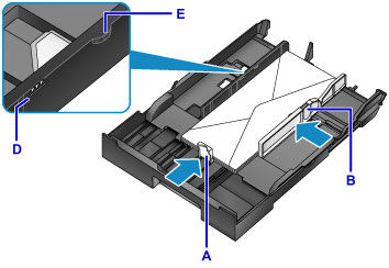

  3. Slide the front (A) and right (B) paper guides out to make room for the paper.

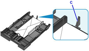

    • Align the stack of envelopes with the edge of cassette 1 as shown.
      Feeding problems may occur if the envelopes are touching the protrusion (C).
  5. Align the front paper guide (A) with the edge of the envelopes.
  6. Slide the right paper guide (B) to align the right and left guides with both edges of the envelopes.
    Do not set the paper guides too firmly against the envelopes, which may cause feeding problems.
     Note
    • Do not load envelopes past the load limit mark (D).
    • Keep the stack height below the paper guide tabs (E).
