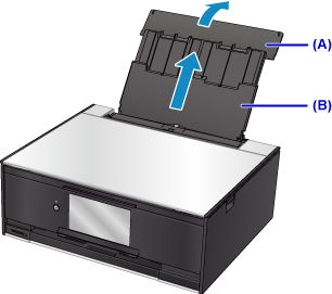

    1. Open the rear tray cover (A) and then pull up the paper support (B).

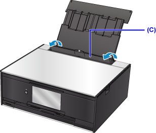

    2. Open the feed slot cover (C).

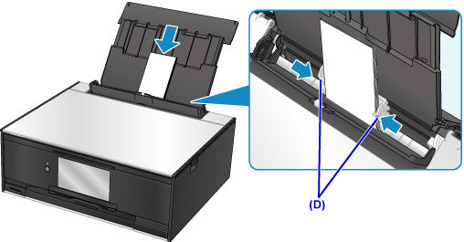

    3. Slide the paper guides to open them, and load the envelopes in the center of theĀ rear tray WITH THE PRINT SIDE FACING UP (Flap side down and flap to the right).
      Fold flap of the envelope and load the envelope in the portrait orientation with the address side facing up.
      Up to 10 envelopes can be loaded at once.
    4. Slide the paper guides (D) to align them with both sides of the envelopes.
      Do not slide the paper guides too hard against the envelopes. The envelopes may not be fed properly.

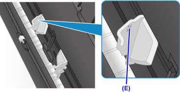

      • Do not load envelopes higher than the load limit mark (E).
    5. Close the feed slot cover (F) gently.
      Important
      • If the feed slot cover is open, paper cannot be fed. Be sure to close the feed slot cover.

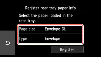

      After closing the feed slot cover, the paper information registration screen for the rear tray is displayed on the touch screen.
    6. Select the size and type of the loaded envelopes in the rear tray at Page size andType, and then select Register.
