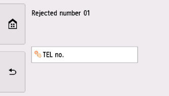

    • By entering the number
      When you select this registration method, the screen to register the fax/telephone number is displayed.
      figure: LCD
      Select the entry field of fax/telephone numbers to display the screen to enter the fax/telephone number. Enter the fax/telephone number you want to register, and then select OK.

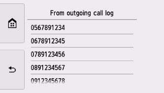

    • From outgoing call log
      When you select this registration method, the screen to select the fax/telephone number from the outgoing call logs is displayed.
      figure: LCD
      Select a fax/telephone number you want to register.
