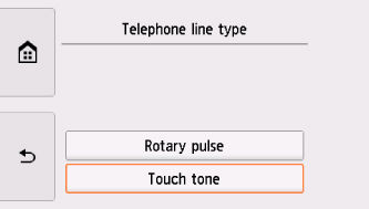

  7. Select Telephone line type.
  8. Select a telephone line type.
    figure: LCD
    Rotary pulse
    Select when your telephone line type is pulse dialing.
    Touch tone
    Select when your telephone line type is tone dialing.
