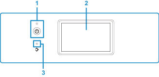

Operation Panel
- (1) ON button/ON lamp
Turns the power on or off. Lights after flashing when the power is turned on. Before turning on the power, make sure that the document cover is closed.
- (2) touch screen
Displays messages, menu items, and the operational status. Directly touch the screen lightly with your finger tip to select a menu item or displayed button. You can also preview photos on a memory card before printing.
- (3) FAX Memory lamp
- When lit, indicates that there are received or unsent documents in the printer's memory.
