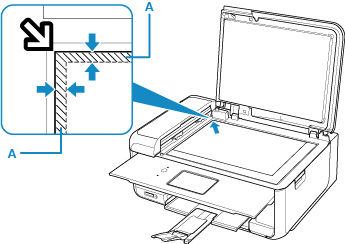

Loading the Original to Be Aligned with the alignment mark
Place the original WITH THE SIDE TO SCAN FACING DOWN on the platen glass and align it with the alignment mark . Portions placed on the diagonally striped area cannot be scanned.
 Important
  • The printer cannot scan the striped area (A) (0.04 inches (1 mm) from the edges of the platen glass).
