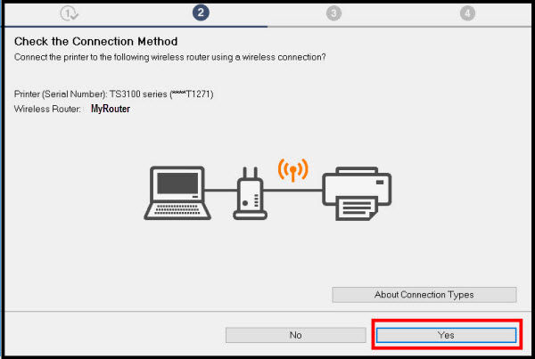

  7. Select Yes to the connection method.
    Yes selected on Connection Method screen
