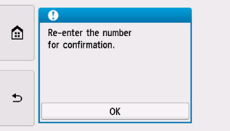

If you send a fax with this function, the following screen is displayed after entering the recipient's fax/telephone number.
figure: LCD
Enter the recipient's fax/telephone number again.
