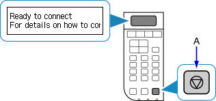

  1. Press the Setup button (A) on the printer.
    figure: Press the Stop button
