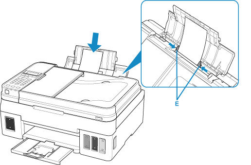

    4. Align the paper guides (E) with the paper width.
      Do not slide the paper guides too hard against the paper. The paper may not be fed properly.

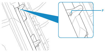

      • Always load paper in the portrait orientation (F). Loading paper in the landscape orientation (G) can cause paper jams.

      4. Align the paper guides (E) with the envelope width.
        Do not slide the paper guides too hard against the envelopes. The envelopes may not be fed properly.

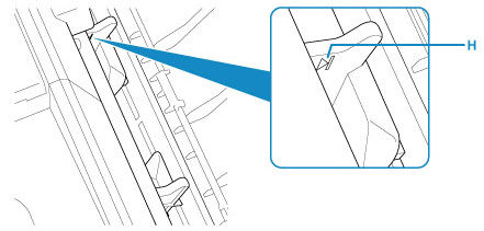

        • Do not load envelopes higher than the load limit mark (F).
