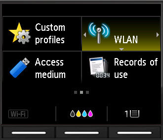

  1. From the Home screen, use the arrows to select WLAN.  Press OK.
  2. Press OK on Wireless LAN setup..

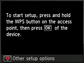

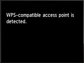

    NOTE: The printer may detect WPS capable routers nearby.
    You will be prompted to press the WPS button on the router.
    On this screen, press the Stop   button.  Then, proceed to the next step.

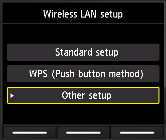

  3. Select Other setup and press OK.
  4. Select Cableless setup and press OK.

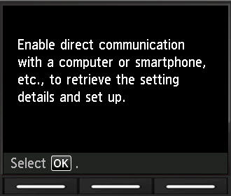

  5. Press OK.

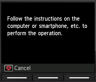

  6. When the screen below appears, continue with the setup  on your mobile device using the mobile app or on your computer using the setup program.  Follow any onscreen instructions.
