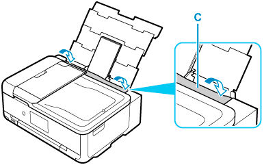

  3. Open the feed slot cover (C).

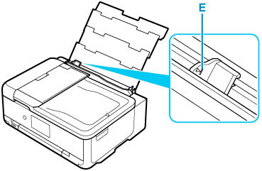

    • Do not load envelopes higher than the load limit mark (E).
  7. Close feed slot cover (C) gently.
     Important
    • If the feed slot cover is open, paper cannot be fed. Be sure to close the feed slot cover.

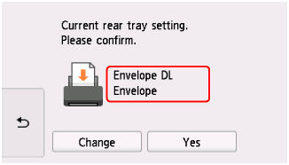

    After closing the feed slot cover, the paper setting confirmation screen for the rear tray appears on the touch screen.
  8. If page size and media type shown on touch screen match size and type of envelopes loaded in rear tray, select Yes.
    If not, select Change to change the settings in accordance with the size and type of the loaded envelopes.

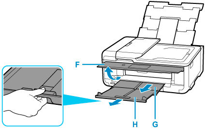

  9. Open operation panel (F), and then pull out paper output tray (G) and paper output support (H).
    Be sure to open the operation panel before printing. If the operation panel is close, the printer does not start printing.
