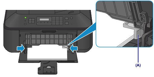

(1) Open the front cover gently, and extend the paper support.
(2) Use the right paper guide (A) to slide both paper guides all the way out.
(3) Load the paper in the center of the front tray WITH THE PRINT SIDE FACING DOWN.
Push the paper stack all the way to the back of the front tray.
(4) Slide the right paper guide (A) to align the paper guides with both sides of the paper stack.
Do not slide the paper guides too hard against the paper. The paper may not be fed properly.
