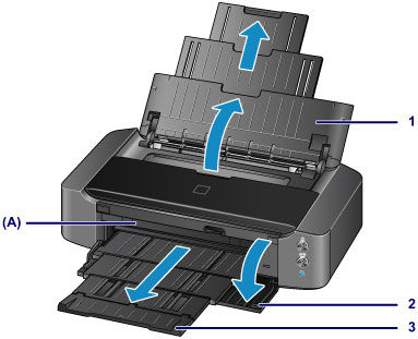

    1. Open the paper support, and pull it out.
    2. Open the front cover gently.
       Important
      • If the disc tray guide (A in step 3 below) is open, close it.
    3. Pull out the paper output tray.

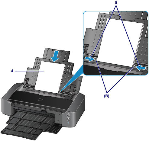

    4. Slide the paper guides (B) to open them, and load the paper in the center of the rear tray WITH THE PRINT SIDE FACING YOU.
    5. Slide the paper guides (B) to align them with both sides of the paper stack.
      Do not slide the paper guides too hard. The paper may not be fed properly.
       Important
      • Always load paper in the portrait orientation (C). Loading paper in the landscape orientation (D) can cause paper jams.

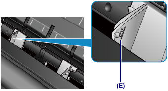

      • Do not load sheets of paper higher than the load limit mark (E).
