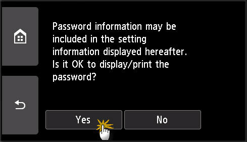

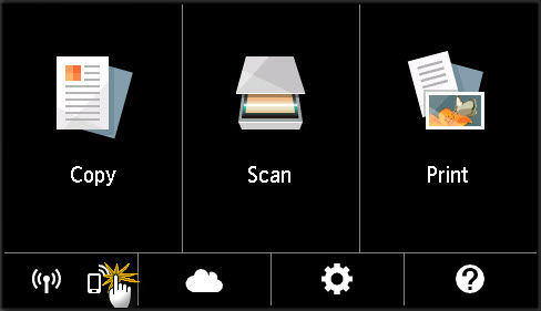

  1. On the HOME screen, tap the network icon at the lower left.

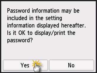

    At the prompt, tap Yes.

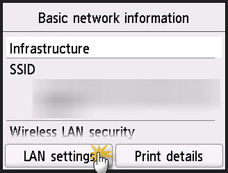

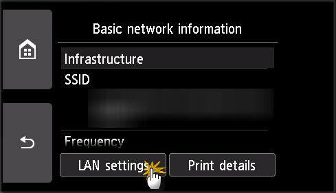

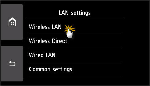

  2. Tap LAN settings.

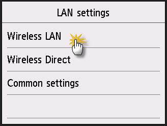

  3. On the LAN settings screen, tap Wireless LAN.

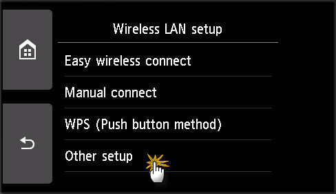

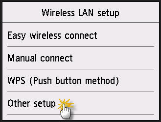

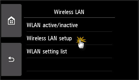

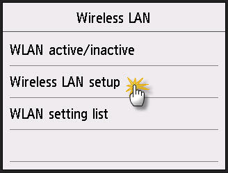

  4. Tap Wireless LAN setup.

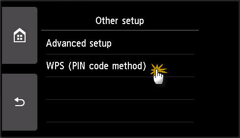

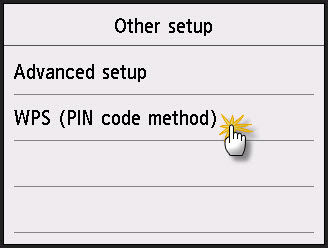

  5. Tap Other setup.

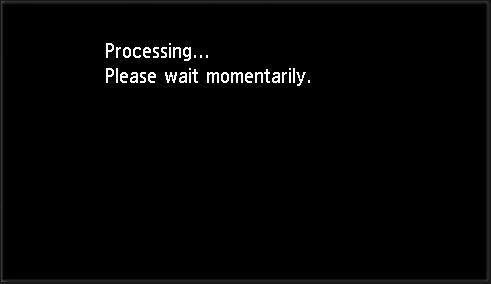

  6. Tap WPS (PIN code method).

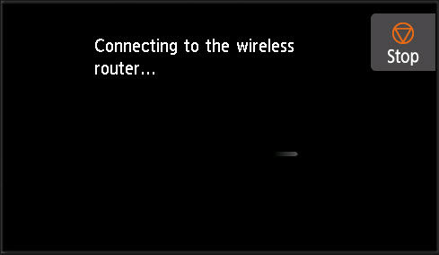

    The printer will process for a few moments.

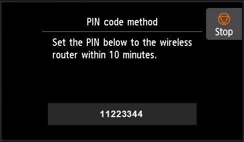

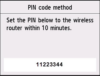

  7. A PIN code will appear on the screen.
    The PIN code must be entered into your router.  Please refer to your router's documentation for information on how to enter a PIN code from a device.

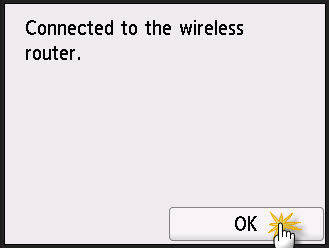

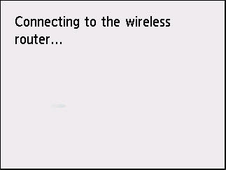

    After the PIN code has been entered into the router, the printer will attempt to connect to the network.

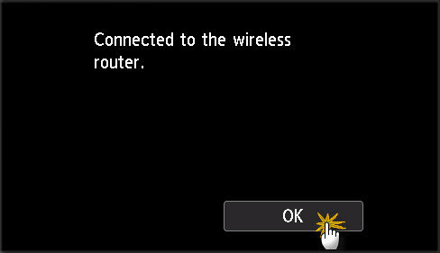

  8. After the printer has connected, tap OK.
