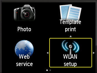

  1. Press the Menu  Menu button button.
  2. Use the arrows to select WLAN setup, then press the OK button.

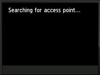

  3. The printer will search for nearby wireless networks.

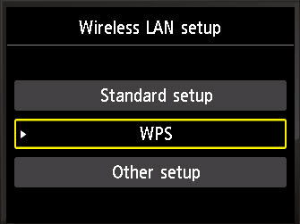

  4. Use the arrows to select WPS, and then press the OK button.
    Select WPS

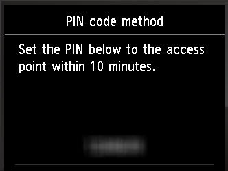

  5. Use the arrows to select PIN code method, then press the OK button.
    Select PIN code method.
  6. A PIN code will appear on the screen.
  7. The PIN code must be entered into your router.  Please refer to your router's documentation for information on how to enter a PIN code from a device.

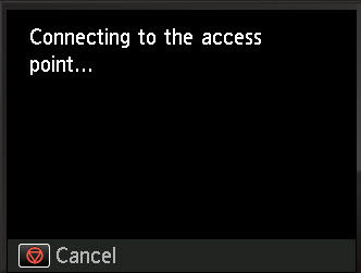

  8. After the PIN code has been entered into the router, the printer will attempt to connect to the network.
    The printer will attempt to connect to the network.

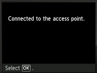

  9. After the printer has connected, press the OK button.
