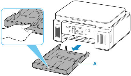

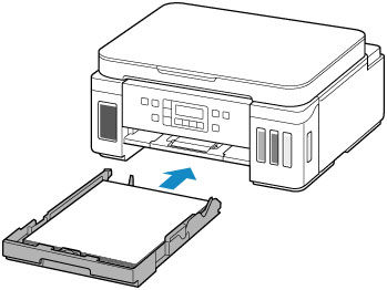

  2. Pull out the cassette (A) from the printer.

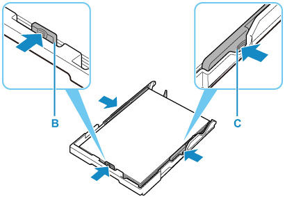

  3. Slide paper guides (B) in front and (C) on right to open guides.

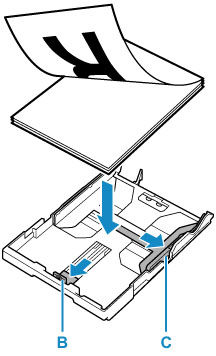

  4. Load paper stack in portrait orientation WITH PRINT SIDE FACING DOWN, and place it in center of cassette.
    Important
    • Always load paper in portrait orientation (E). Loading paper in landscape orientation (F) can cause paper jams.
    Note

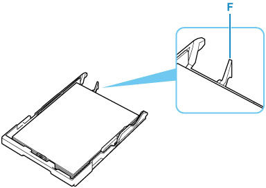

    • Align the paper stack with the edge of the cassette as shown in the figure below.
      If the paper stack is in contact with the protrusion (F), the paper may not be fed properly.
  5. Slide front paper guide (B) to align it with paper stack.
    Align paper guide with where it clicks into place.
  6. Slide right paper guide (C) to align it with paper stack.
    Do not slide the paper guide too hard against the paper. The paper may not be fed properly.
    Note

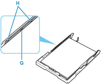

    • Do not load sheets of paper higher than the load limit mark (G).
    • Keep the paper stack height below the tabs (H) of the paper guides.
  7. Insert cassette into printer.
    Push the cassette into the printer until it stops.

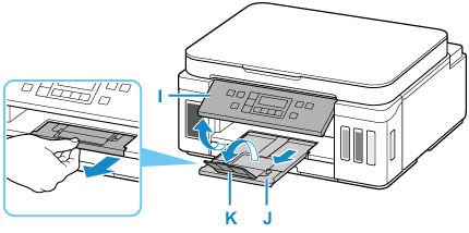

  11. Open operation panel (I), pull out paper output tray (J), and then open output tray extension (K).
    Be sure to open the operation panel before printing. If the operation panel is closed, the printer does not start printing.
