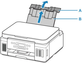

  2. Open rear tray cover (A). Pull straight up and fold back paper support (B).

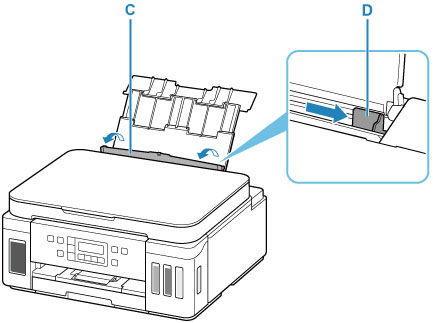

  3. Open the feed slot cover (C).
  4. Slide right paper guide (D) to open both paper guides.

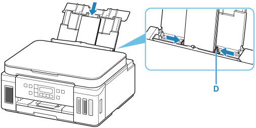

  6. Slide right paper guide (D) to align with both sides of envelopes.
    Do not slide the paper guides too hard against the envelopes. The envelopes may not be fed properly.

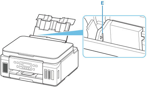

    • Do not load envelopes higher than the load limit mark (E).

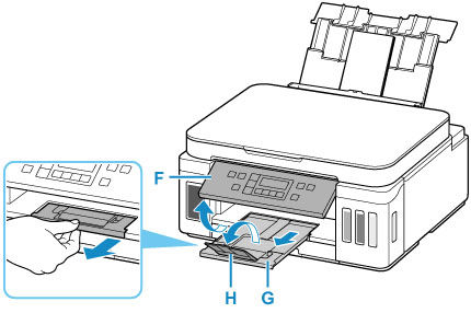

  11. Open operation panel (F), pull out paper output tray (G), and then open output tray extension (H).
    Be sure to open the operation panel before printing. If the operation panel is closed, the printer does not start printing
