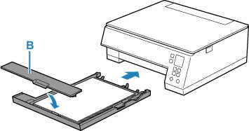

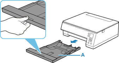

  2. Pull out the cassette (A) from the printer.

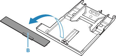

  3. Remove the cassette cover (B).

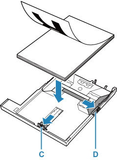

  4. Slide paper guides (C) in front and (D) on right to open guides.
  5. Load paper stack in portrait orientation WITH PRINT SIDE FACING DOWN, and place it in center of cassette.

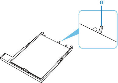

    • Align the paper stack with the edge of the cassette as shown in the figure below.
      If the paper stack is in contact with the protrusion (G), the paper may not be fed properly.

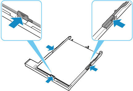

  6. Slide front paper guide (C) to align it with paper stack.
    Align paper guide with where it clicks into place.
  7. Slide right paper guide (D) to align it with paper stack.
    Do not slide the paper guide too hard against the paper. The paper may not be fed properly.

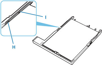

    • Do not load sheets of paper higher than the load limit mark (H).
    • Keep the paper stack height below the tabs (I) of the paper guides.
  8. Mount cassette cover (B) and insert cassette into printer.
    Push the cassette into the printer until it stops.
