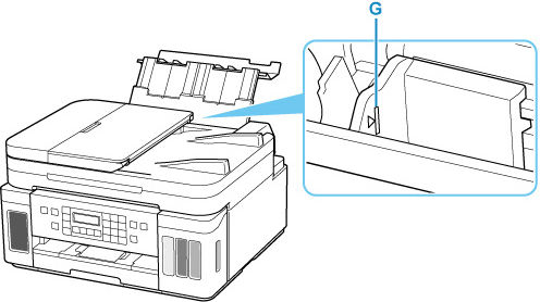

Open the rear tray cover (A). Pull it straight up and fold back the paper support (B).
Open the feed slot cover (C).
Slide the right paper guide (D) to open both paper guides.
Load the paper stack in portrait orientation WITH THE PRINT SIDE FACING UP.
Slide the right paper guide (D) to align with both sides of the paper stack.
