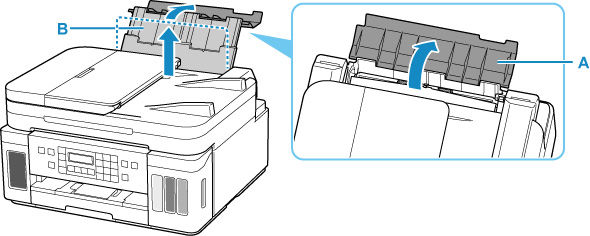

Open the rear tray cover (A). Pull it straight up and fold back the paper support (B).

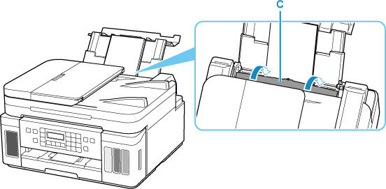

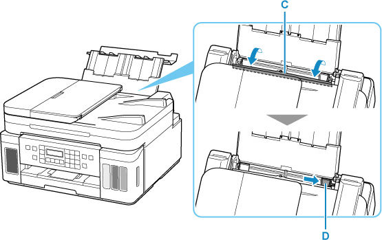

Open the feed slot cover (C).

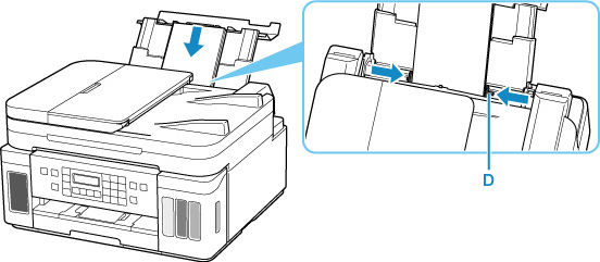

Slide the right paper guide (D) to open both paper guides.

Fold the flap of the envelope and load the envelope in portrait orientation with the address side facing up.
Slide the right paper guide (D) to align with both sides of the envelopes.
Do not slide the paper guides too hard against the envelopes. If you do, the envelopes may not be fed properly.

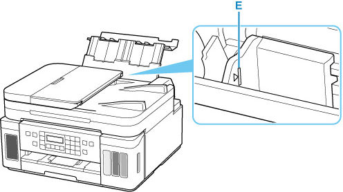

Do not load envelopes higher than the load limit mark (E).
Close feed slot cover (C) gently.
Important
If the feed slot cover is open, paper cannot be fed. Be sure to close the feed slot cover.

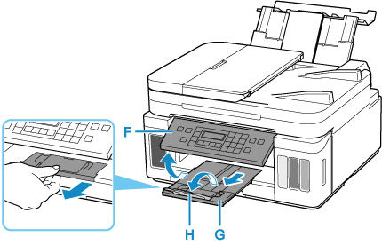

Open the operation panel (F), pull out the paper output tray (G), and then open the output tray extension (H).
Be sure to open the operation panel before printing. If the operation panel is closed, the printer will not start printing.
