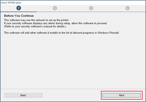

Run the setup file and click Start Setup.
Read the network security notice and click Next.
