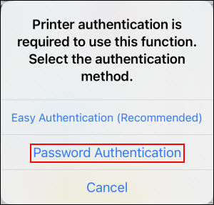

If you see a prompt similar to the following, select Password Authentication.

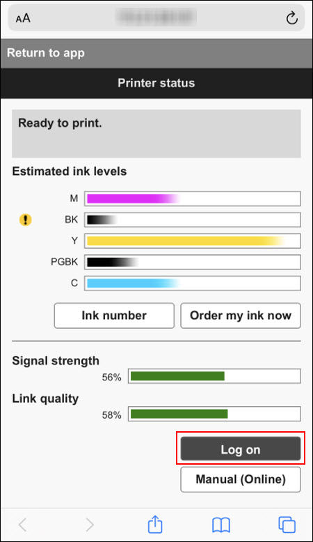

The printer's Remote UI will appear in a web browser. Select Log on.

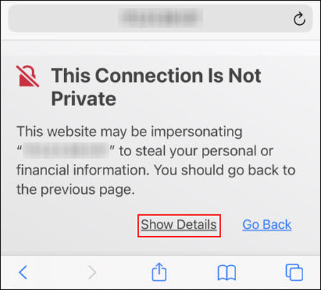

If a warning message similar to the one shown below appears, select Show Details or the appropriate option.

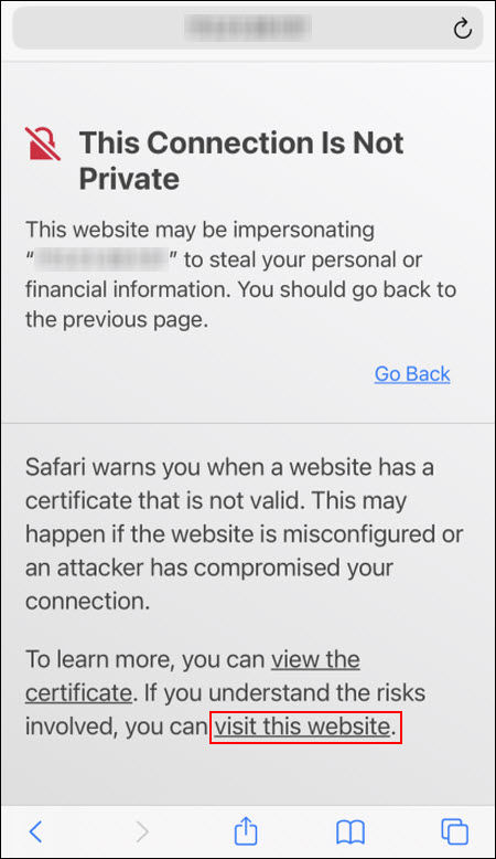

Select visit this website (the web browser that you use may offer a different option, select it to continue).
You may need to select another option to confirm that you want to proceed. If you are prompted again to continue, select the appropriate affirmative option.

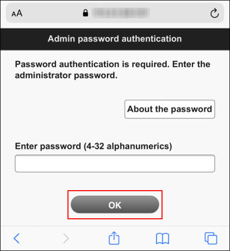

Enter the password for your printer, then select OK.

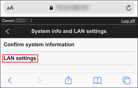

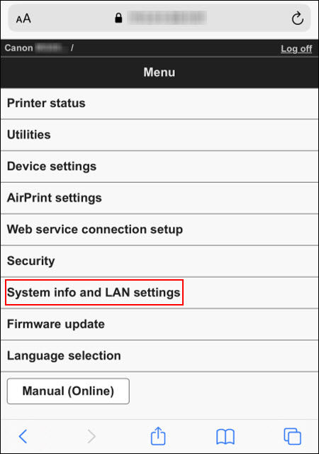

Select System info and LAN settings.
Select LAN settings.

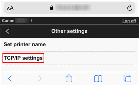

Select Other settings.

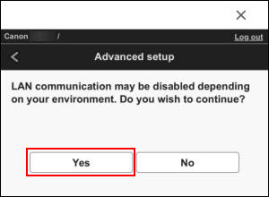

For some models, select Advanced setup.

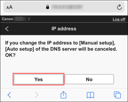

Select Yes. The displayed message may vary depending on the printer model you are using.

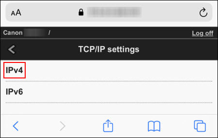

Select TCP/IP settings.

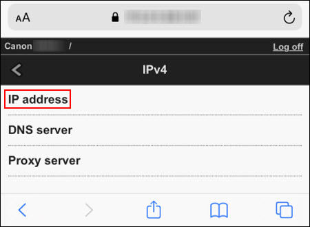

Select IPv4.

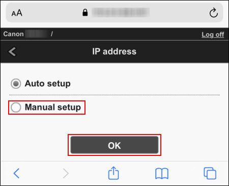

Select IP address.

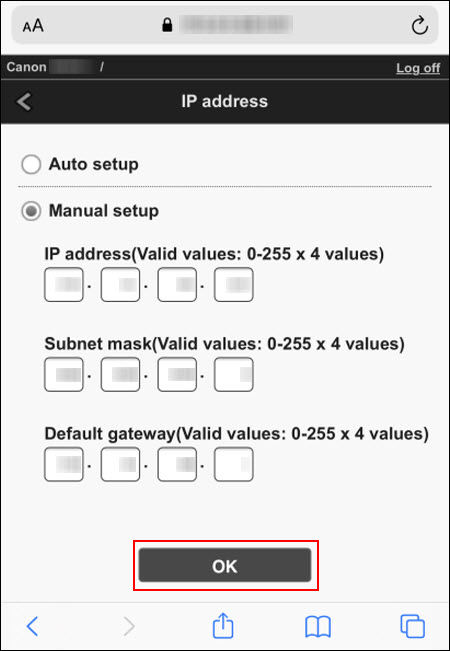

Select Manual setup, then select OK.
Enter the IP address, Subnet mask, and Default gateway. Select OK when finished.
If this prompt appears, select OK.
The IP address will be set to the one you specified.
