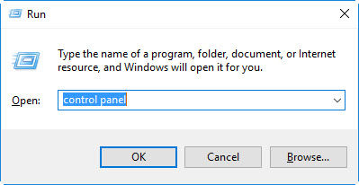

  1. Hold down the Windows  Window icon key and type R. In the Run box, type control panel and select OK.
    Run dialog box with "control panel" typed into the Open: field
