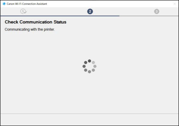

  3. The Wi-Fi Connection Assistant will attempt to communicate with the printer.
    Communicating with the printer

    After the computer has sent the network information over to the printer, it will reconnect to the router.  The computer will then attempt to communicate with the printer.
