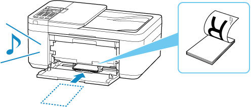

  4. Load the paper stack in portrait orientation the WITH SIDE TO PRINT ON FACING DOWN, and place it in the center of the front tray.
    Insert the leading edge of paper stack until you hear a sound.
    When you the load paper stack, the paper information registration screen is displayed on the LCD.
     Always load paper in portrait orientation (C). Loading paper in landscape orientation (D) can cause paper jams.
    Load the paper in portrait orientation

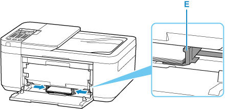

  5. Slide the right paper guide to align the paper guides with both sides of the paper stack.
    Don't slide the paper guides too hard against the paper. The paper may not be fed properly.
    Slide the right guide to align both guides against the sides of the paper stack
     Keep the paper stack height below the tabs (E) of the paper guides.

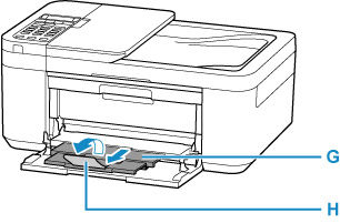

  7. Pull the paper output support (G) and open the output tray extension (H).
    Pull the paper output support and open the output tray extension
