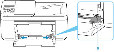

  3. Slide the right paper guide (B) to open both paper guides.

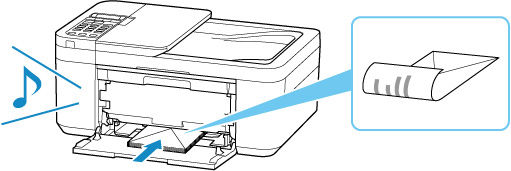

    Insert the leading edge of envelopes until you hear a sound. Up to 5 envelopes can be loaded at once.
    When you load envelopes, the registration screen of paper information is displayed on the LCD.

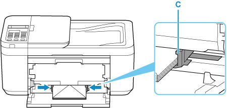

  5. Slide the right paper guide to align both paper guides with both sides of the envelopes.
    Don't slide the paper guides too hard against the envelopes. The envelopes may not be fed properly.
     Keep the envelope stack height below the tabs (C) of the paper guides.

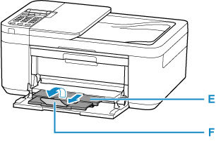

  7. Pull the paper output support (E) and open the output tray extension (F).
