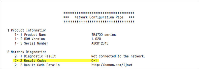

When examining a Network Configuration Page, item 2-2 provides a result code, which indicates the status of the network connection for the printer.
Select the code that corresponds to what is printed on your Network Configuration Page.
C-0

C-1
The printer's Wi-Fi setting is disabled. (You can also check if the Wi-Fi icon does not appear on the printer's screen.)
Enable the Wi-Fi setting in the printer's settings screen.
