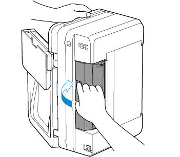

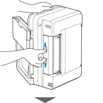

  4. Open the rear cover.
    When you open the rear cover, support the printer with your hand so that it doesn't fall over.
    When you open the rear cover, support the printer with your hand so that it does not fall over
    Open the rear cover

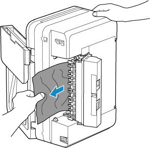

  5. Hold the jammed paper firmly and pull it out slowly.
    When you pull the jammed paper, support the printer with your hand so that it doesn't fall over.
     If the paper is rolled up, pull it out and grasp the edges of the paper.

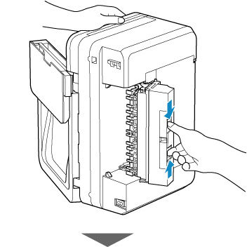

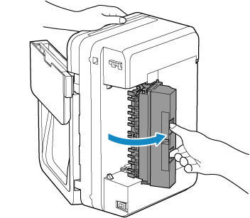

  6. Close the rear cover.
