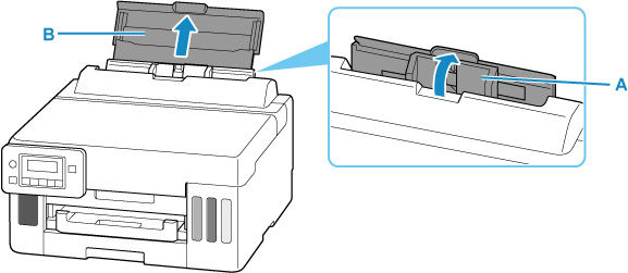

  2. Open the rear tray cover (A) and then pull up the paper support (B).

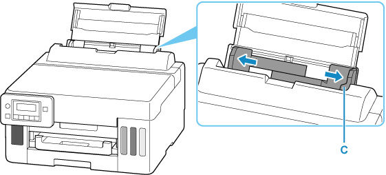

  3. Slide the right paper guide (C) to open both paper guides.

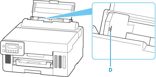

     Don't load envelopes higher than the load limit mark (D).

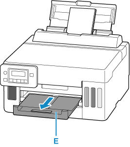

  9. Pull out the paper output tray (E).
