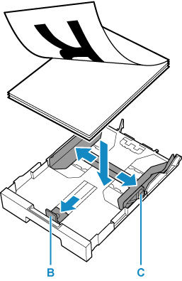

  3. Slide the paper guides (B) in front and (C) on the right to open the guides.
  4. Load the paper stack in portrait orientation WITH THE PRINT SIDE FACING DOWN, and place it in center of the cassette.
    Load the paper face down
     Always load paper in portrait orientation (D). Loading paper in landscape orientation (E) can cause paper jams.

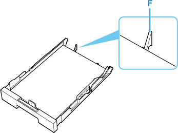

     Align the paper stack with the edge of the cassette as shown in the figure below.
    If the paper stack is in contact with the protrusion (F), the paper may not be fed properly.

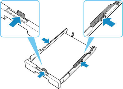

  5. Slide the front paper guide to align it with paper stack.
    Align the paper guide with where it clicks into place.
  6. Slide the right paper guide to align it with the paper stack.
    Don't slide the paper guide too hard against the paper. The paper may not be fed properly.

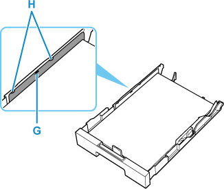

     Don't load sheets of paper higher than the load limit mark (G).
     Keep the paper stack height below the tabs (H) of the paper guides.
