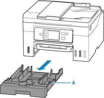

  2. Pull out the cassette (A) from the printer.
    Pull the cassette (A) out from the printer

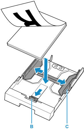

  3. Slide the paper guides (B) in the front and (C) on the right to open the guides.
  4. Load paper stack in portrait orientation WITH THE PRINT SIDE FACING DOWN, and place it in center of cassette.
    Slide the paper guides (B) in the front and (C) on the right to open the guides, then load the paper stack face down in portrait orientation
     Always load paper in portrait orientation (D). Loading paper in landscape orientation (E) can cause paper jams.
    Always load paper in portrait orientation (D), as loading paper in landscape orientation (E) can cause paper jams

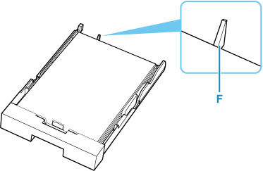

     Align the paper stack with the edge of the cassette. If the paper stack is in contact with the protrusion (F), the paper may not be fed properly.

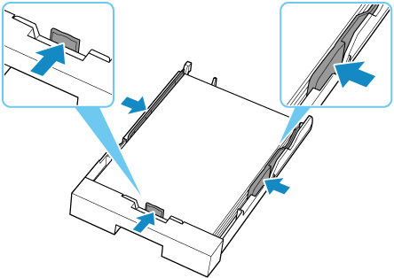

  5. Move the front paper guide and adjust the guide to the edge of the paper stack.
    Align the paper guide with where it clicks into place.
  6. Move the right paper guide and adjust the guides to edges of the paper stack.
    Do not slide the paper guide too tightly against the paper. The paper may not be fed properly.
    Adjust the front and right paper guides against the edge of the paper stack

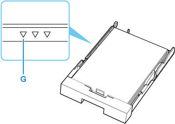

     Do not load sheets of paper higher than the load limit mark (G).
    Do not load sheets of paper beyond the load limit mark (G)

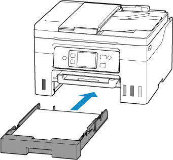

  7. Push the cassette into the printer until it stops.
    After inserting the cassette into the printer, the paper setting confirmation screen for the cassette appears on the touch screen.
