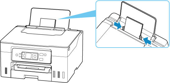

  5. Move the right paper guide and adjust the guides to both edges of the envelopes.
    Do not slide the paper guides too tightly against the envelopes. The envelopes may not be fed properly.

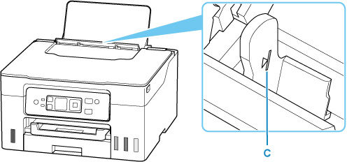

     Do not load envelopes higher than the load limit mark (D).
    Do not load envelopes beyond the load limit mark (D)
