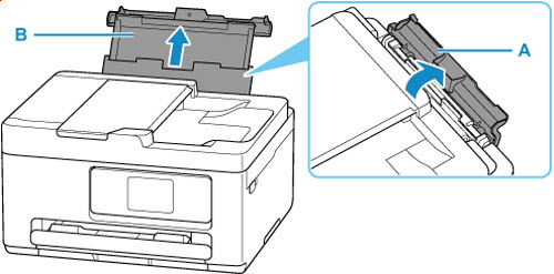

  2. Open the rear tray cover (A). Pull straight up and fold back the paper support (B).

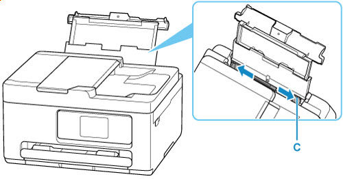

  3. Slide the right paper guide (C) to open both paper guides.
    Slide the right paper guide (D)

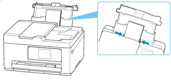

  5. Move the right paper guide and adjust the guides to both edges of the envelopes.
    Don't slide the paper guides too tightly against the envelopes. The envelopes may not be fed properly.
    Slide the right paper guide to align the guides with the sides of the envelopes

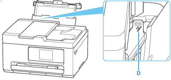

     Don't load envelopes higher than the load limit mark (D).

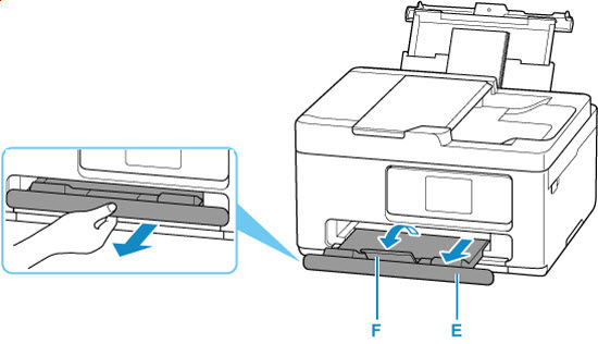

  7. Pull out the paper output tray (E) and open the paper output support (F).
    Pull out the paper output tray (F) and open the paper output support (G)
