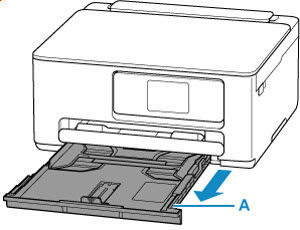

  2. Pull the cassette (A) out of the printer.
    Remove the cassette (A) from the printer

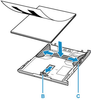

  3. Slide the paper guides (B) in front and (C) on the right to open guides.
  4. Load the paper stack in portrait orientation WITH THE PRINT SIDE FACING DOWN, and place it in the center of the cassette.
    Load the stack of paper into the cassette with the side you will print on facing down
     Always load paper in portrait orientation (D). Loading paper in landscape orientation (E) can cause paper jams.

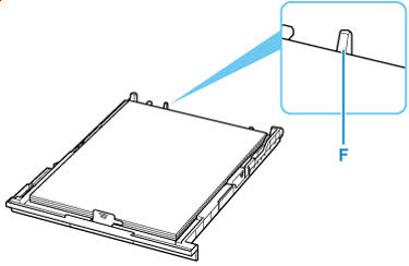

     Align the paper stack with the edge of the cassette as shown in the figure below.
    If the paper stack is in contact with the protrusion (F), the paper may not be fed properly.
    If the paper stack makes contact with the protrusion (F), paper jams may occur

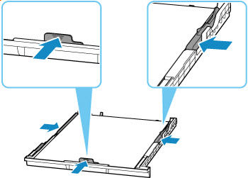

  5. Slide the front paper guide to align it with the paper stack.
    Align the paper guide with where it clicks into place.
  6. Slide the right paper guide to align it with the paper stack.
    Do not slide the paper guide too hard against the paper. The paper may not be fed properly.

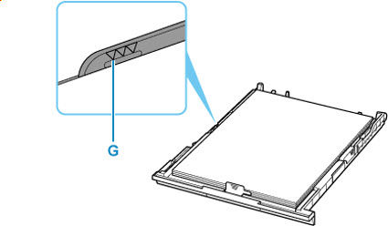

     Do not load sheets of paper higher than the load limit mark (G).
    Keep the paper stack height below the tabs (H) of the paper guides

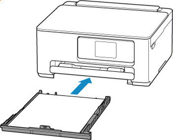

  7. Insert the cassette into the printer.
    Push the cassette into the printer until it stops.

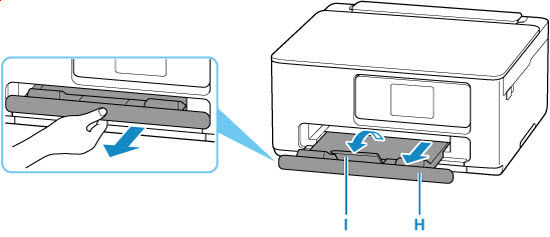

  9. Pull out the paper output tray (I) and open the paper output support (J).
